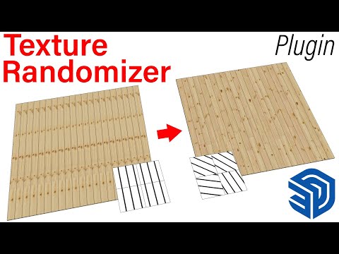

    • Texture Randomizer Plugin for SketchUp - TutorialsUp (TutorialsUp)Texture Randomizer Plugin for SketchUp - TutorialsUp (TutorialsUp)
