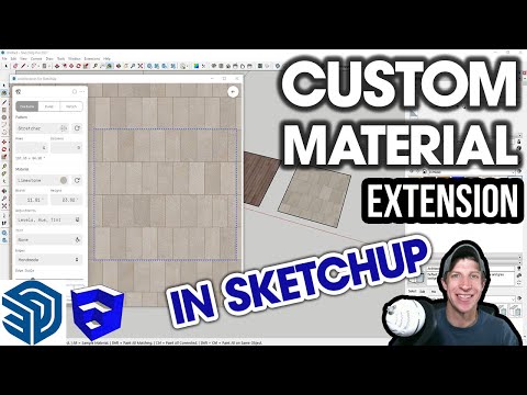

    • Creating Custom Materials INSIDE SKETCHUP Using the Architextures Extension! (TheSketchUpEssentials)Creating Custom Materials INSIDE SKETCHUP Using the Architextures Extension! (TheSketchUpEssentials)
