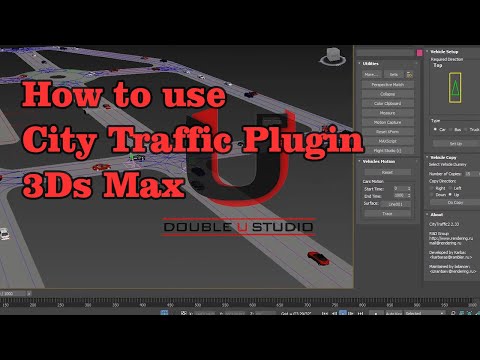

How to use City Traffic Plugin | 3Ds Max (Double U Studio)
