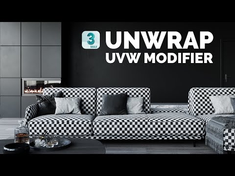

    • Unwrap UVW Modifier in 3ds Max | I made it simple (Arch Viz Artist)Unwrap UVW Modifier in 3ds Max | I made it simple (Arch Viz Artist)
