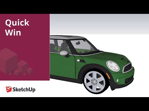

    • Select by Material in SketchUp - Quick Win (Trimble SketchUp)Select by Material in SketchUp - Quick Win (Trimble SketchUp)
