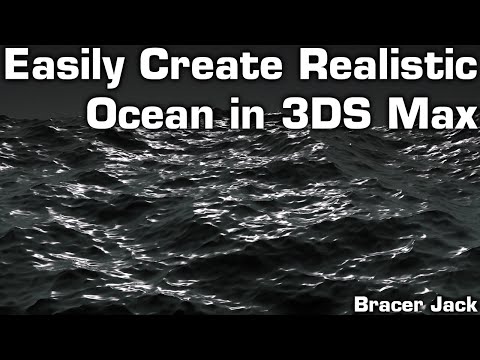

<li><div class="lotuz-yt" data-yt="aWwepDs4eeU"><span class="lotuz-yt-media"><img class="lotuz-yt-thumb" src="https://i.ytimg.com/vi/aWwepDs4eeU/hqdefault.jpg" alt="Easy Realistic Ocean in 3DS Max [Tutorial] (Bracer Jack)" /><button class="lotuz-yt-play" aria-label="Phát video"></button></span><span class="lotuz-yt-title">Easy Realistic Ocean in 3DS Max [Tutorial] (Bracer Jack)</span></div></li>
