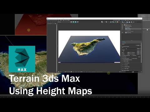

<li><div class="lotuz-yt" data-yt="s8V_5YA3cL0"><span class="lotuz-yt-media"><img class="lotuz-yt-thumb" src="https://i.ytimg.com/vi/s8V_5YA3cL0/hqdefault.jpg" alt="Create Any Terrain In The World Using Height Maps In 3DS MAX (Daniel Szalapski)" /><button class="lotuz-yt-play" aria-label="Phát video"></button></span><span class="lotuz-yt-title">Create Any Terrain In The World Using Height Maps In 3DS MAX (Daniel Szalapski)</span></div></li>
