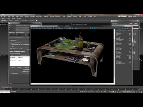

<li><div class="lotuz-yt" data-yt="DTMcGE-X7WQ"><span class="lotuz-yt-media"><img class="lotuz-yt-thumb" src="https://i.ytimg.com/vi/DTMcGE-X7WQ/hqdefault.jpg" alt="How to use Distributed Rendering with Corona Renderer (CG Tricks)" /><button class="lotuz-yt-play" aria-label="Phát video"></button></span><span class="lotuz-yt-title">How to use Distributed Rendering with Corona Renderer (CG Tricks)</span></div></li>

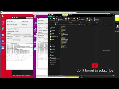

<li><div class="lotuz-yt" data-yt="b_HOFvePzvk"><span class="lotuz-yt-media"><img class="lotuz-yt-thumb" src="https://i.ytimg.com/vi/b_HOFvePzvk/hqdefault.jpg" alt="distributed rendering for Corona master class (ProceduralMindsAi)" /><button class="lotuz-yt-play" aria-label="Phát video"></button></span><span class="lotuz-yt-title">distributed rendering for Corona master class (ProceduralMindsAi)</span></div></li>
